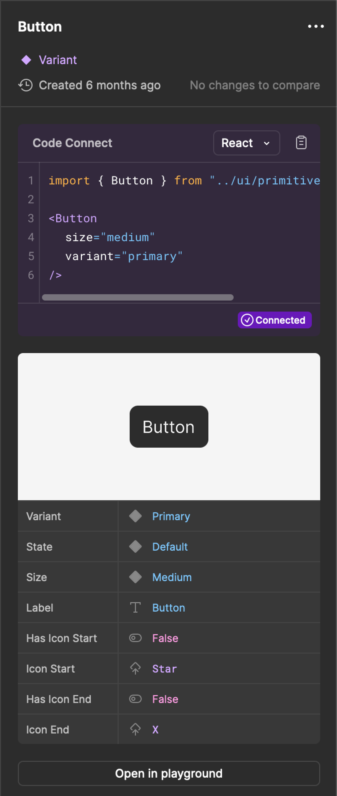

To view the mapped components in Figma, click the links in the list after you publish. The links bring you to the corresponding components in your design system Figma file.
In the toolbar, click
Dev Mode. The code snippet from Code Connect appears in the Inspect panel in the right sidebar.
