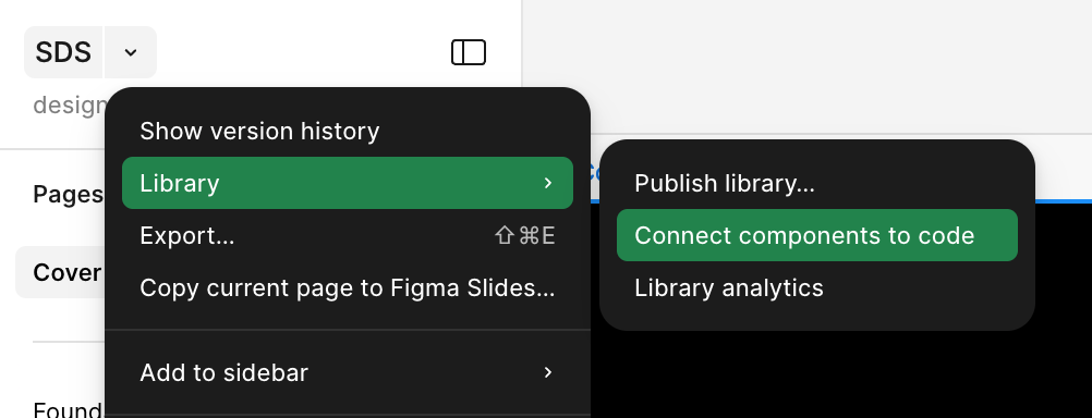

Connecting components from your design library
  1. In Figma, open a library file that contains design components.
  2. Switch to Dev Mode.
  3. From the dropdown menu next to the file name, choose Library → Connect components to code.

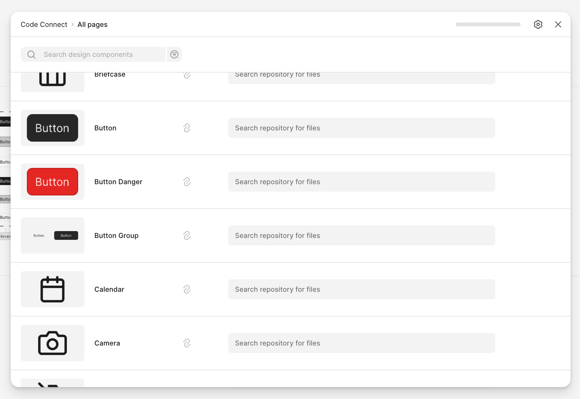

The Code Connect UI opens and lists all published components from the library. From here, you can begin mapping components to your codebase.
Code Connect UI

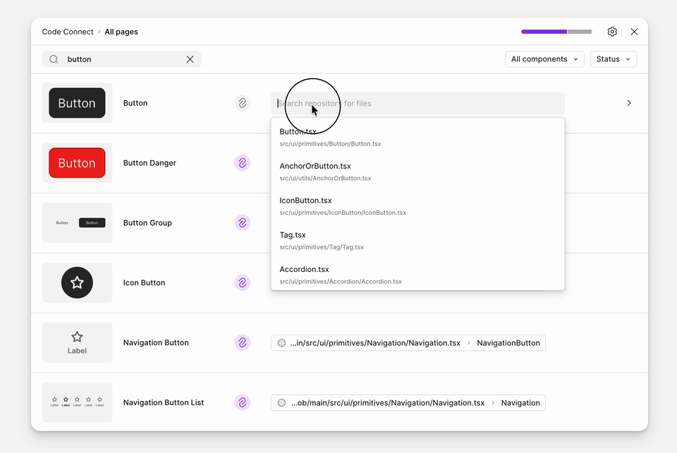

Connect your GitHub repository (optional)
info
Connecting to GitHub is optional. You can map your design system components to code paths manually without a GitHub connection.
Click the Settings icon in the Code Connect UI to connect your repository to GitHub.
Connecting to GitHub provides additional features:
  • Mapping fields will autocomplete with file paths from your repository.
  • You can browse and search for components directly from GitHub.

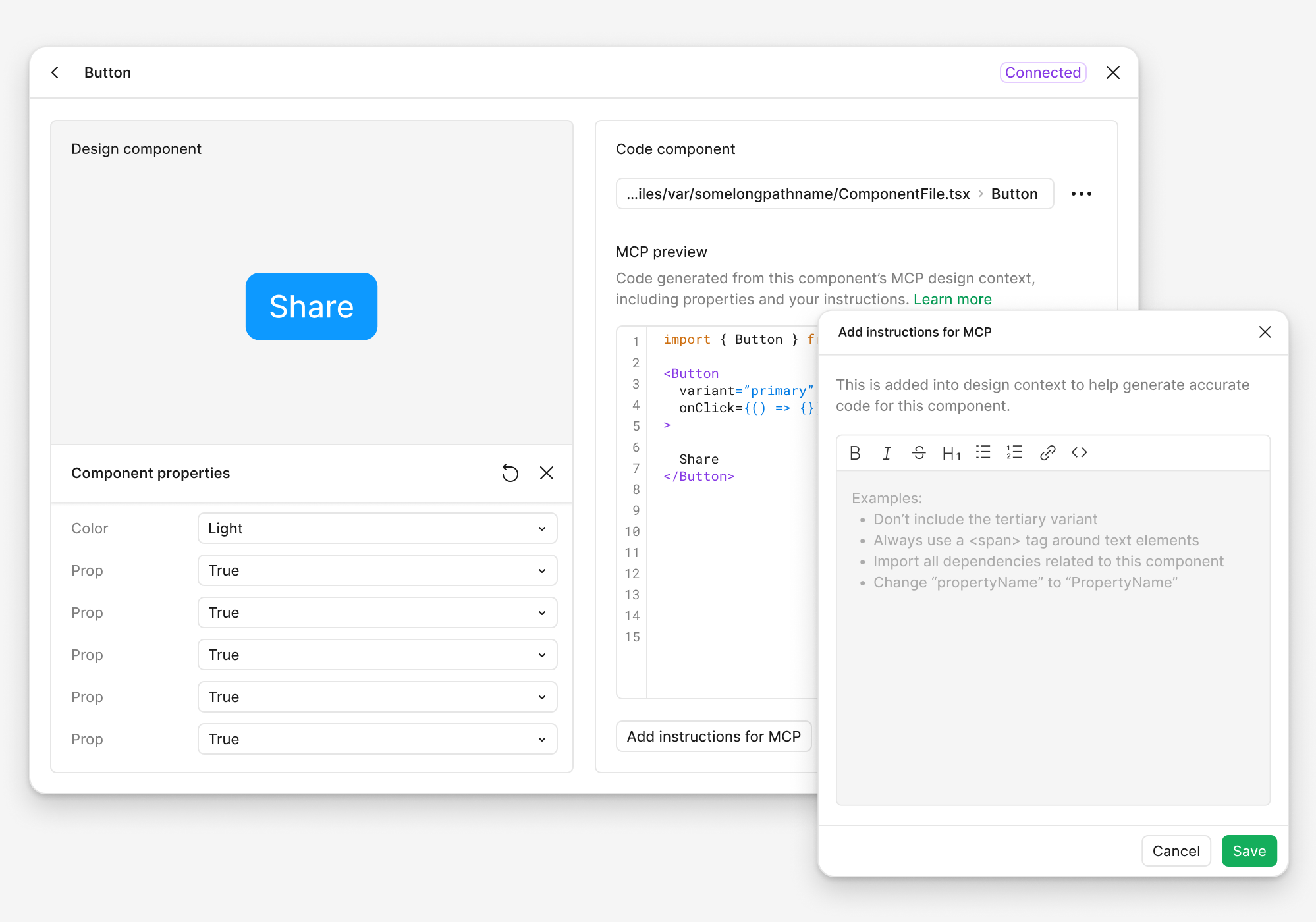

Add custom instructions for AI code generation
Once you've connected a component to your codebase, you can provide additional context to help AI agents generate better code. This is especially useful for components with specific usage patterns, accessibility requirements, or team conventions.
Add instructions for MCP
For any connected component, you can add custom instructions that will be used by your LLM via the Figma MCP server:
  1. In the Code Connect UI, select a connected component.
  2. Click the Add instructions for MCP button.
  3. Write user prompts that describe how the component should be used, including:
    • Specific props or configuration patterns
    • Accessibility considerations
    • Common use cases or variations
    • Team-specific coding conventions
These instructions are sent along with your component mapping to the MCP server, helping the AI generate code that better matches your design system's implementation.
Preview AI-generated code snippets
To verify that your mappings and instructions will produce the right code, you can preview AI-generated snippets directly in the Code Connect UI:
  1. Select a connected component in the Code Connect UI.
  2. Change the properties of the design component to test different configurations (e.g., different button sizes, states, or variants).
  3. View the code snippet preview to see what your LLM would generate based on:
    • The component mapping
    • Your custom MCP instructions
    • The current property values
This preview helps you refine your instructions and ensure that the AI will generate appropriate code for all variations of your component.
