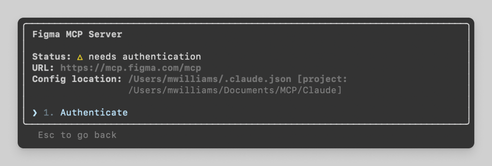

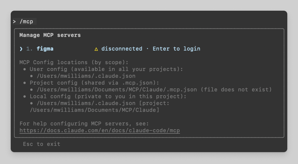

Type
/mcpin Claude to manage your MCP Servers and select figma.

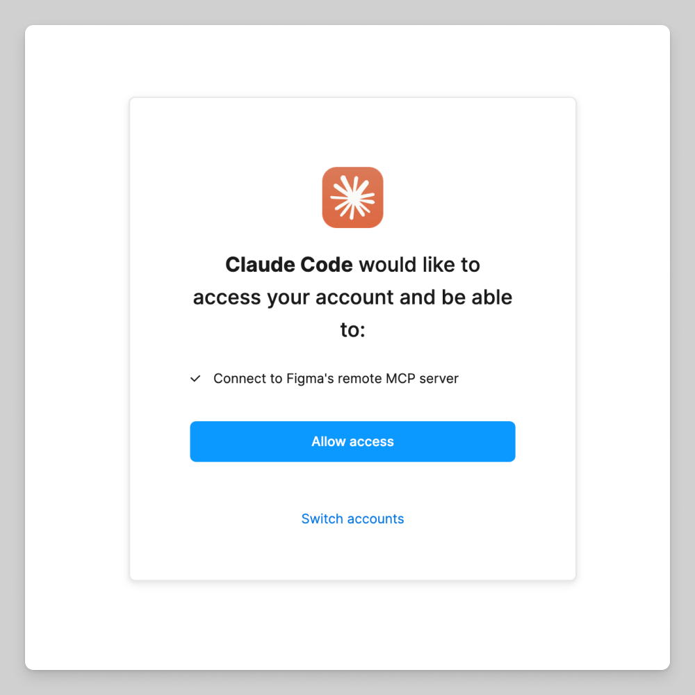

Select Authenticate.
Click Allow Access.
Back in Claude code, you should see:
Authentication successful. Connected to figma -

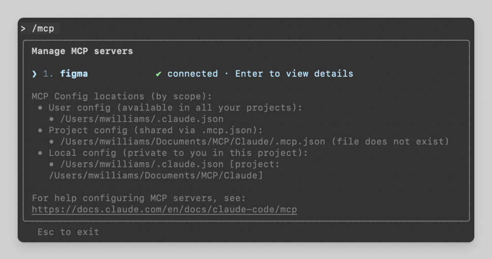

Confirm your MCP Server is connected using
/mcpcommand in Claude Code.

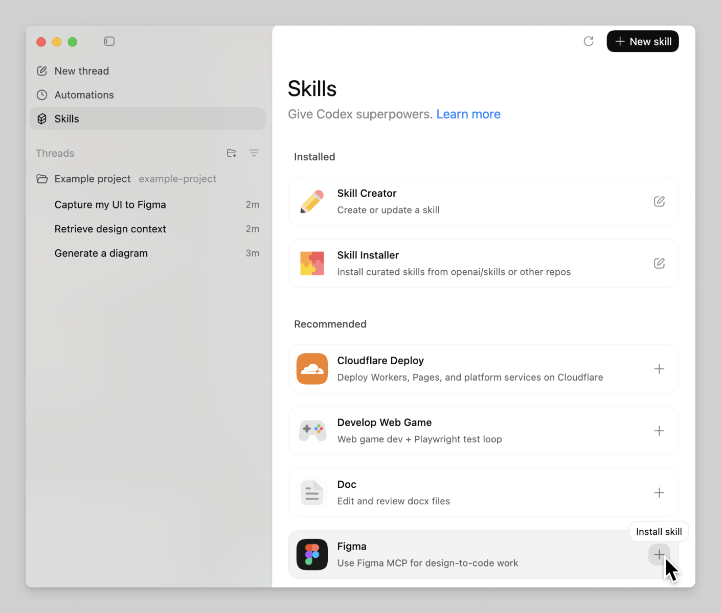

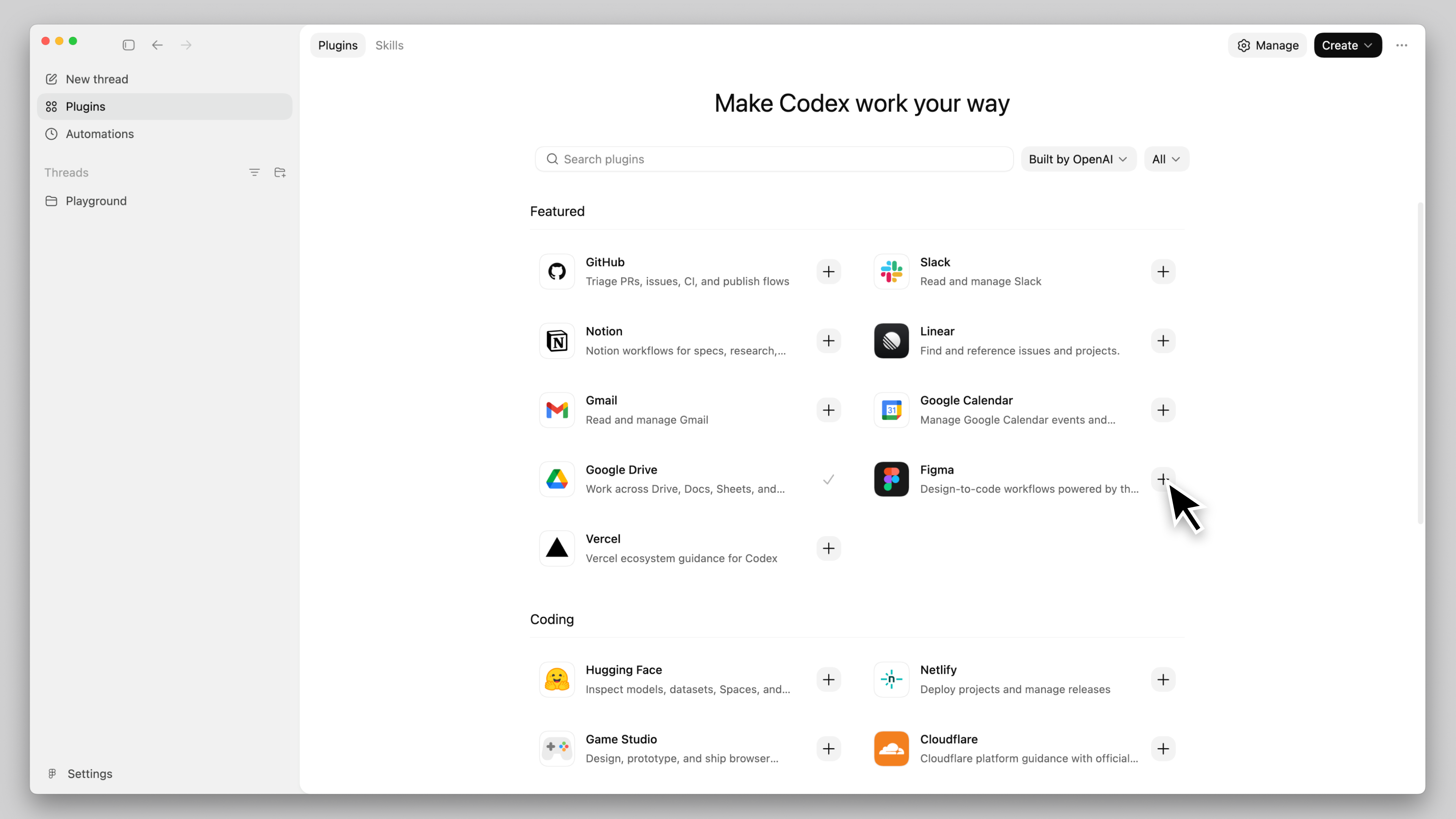

Using the Codex app (preferred):
In the upper-left corner of the Codex app, click Skills.
In the list of skills, click + next to the Figma skill.
In the bottom left corner of the Codex app, click Settings, and then MCP servers.
In the list of recommended servers, click Install and authenticate for the Figma server. When you're prompted, authorize the server.

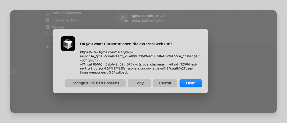

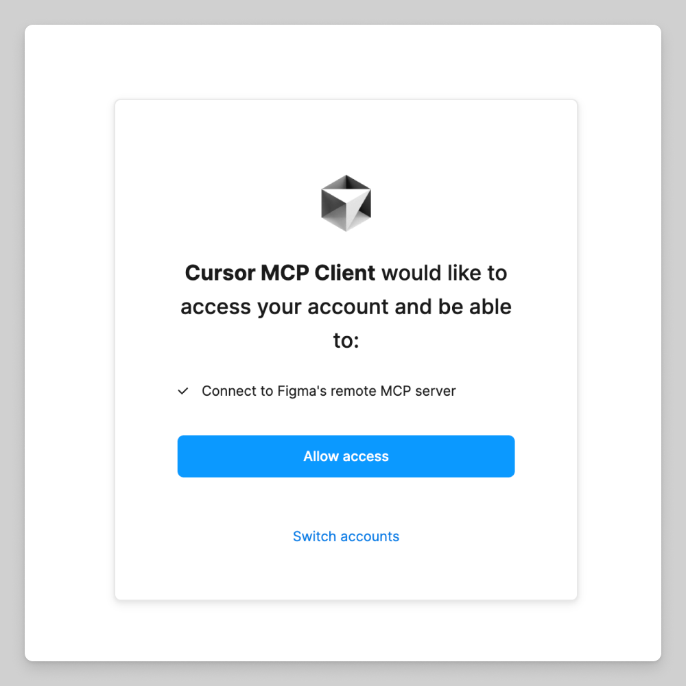

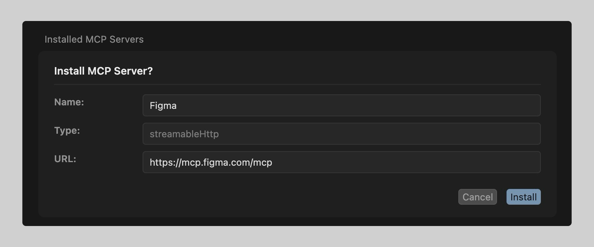

- Click the Figma MCP server deep link. This will open the MCP configuration in Cursor.
- Click Install under 'Install MCP Server?'
- Click Connect next to Figma to begin the authentication process.
- Click Open.
- Allow access

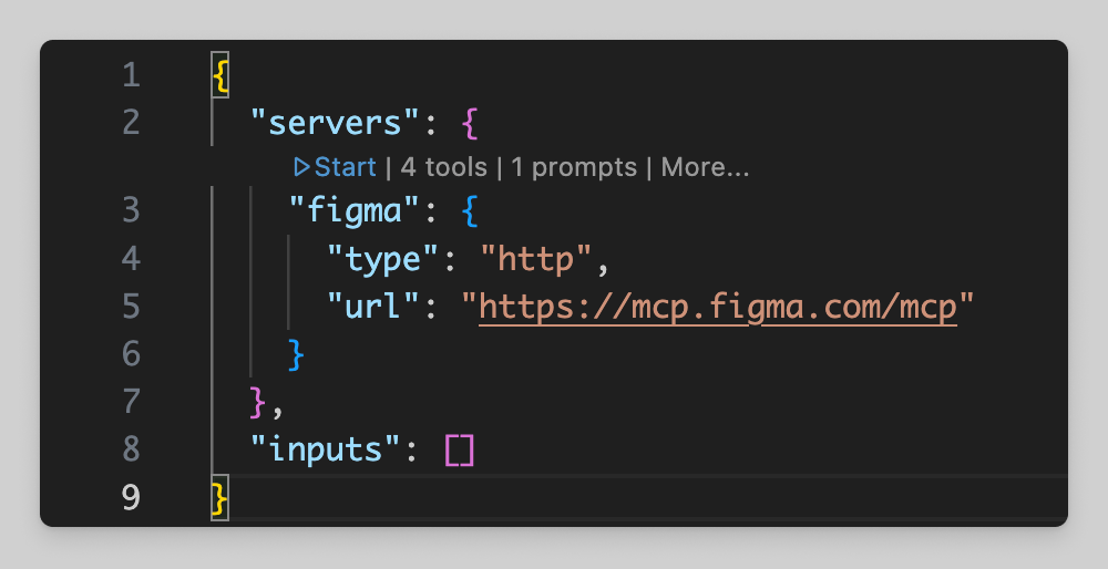

In the
mcp.jsonfile, paste the following code:{ "inputs": [], "servers": { "figma": { "url": "https://mcp.figma.com/mcp", "type": "http" } } } -

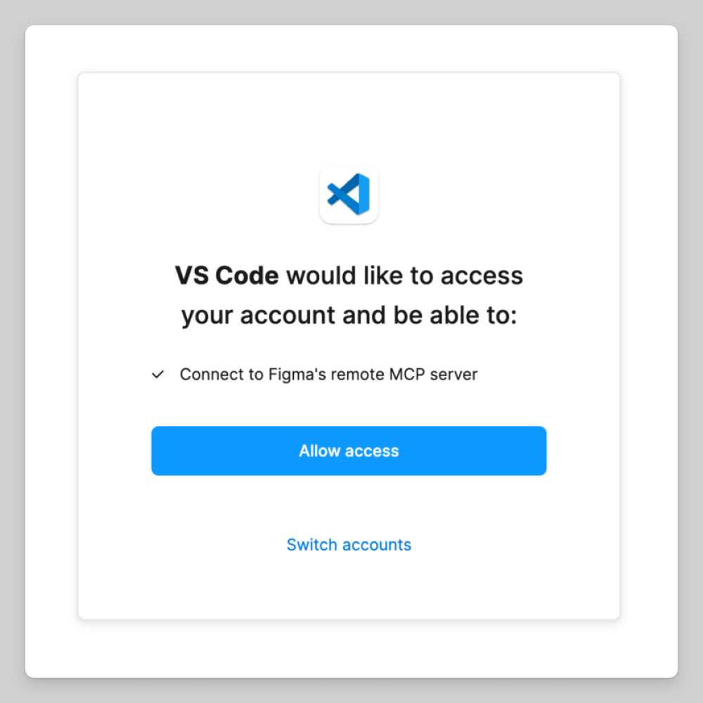

Click on Start (above the MCP server name).
Allow Access.
