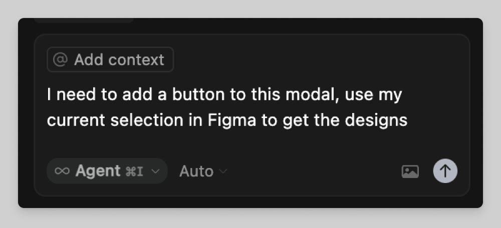

Selection-based
  1. Select a frame or layer inside Figma using the desktop app.
  2. Prompt your client to help you implement your current selection.
    MCP client with selection-based prompt

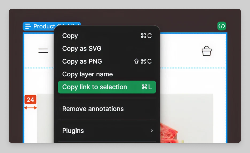

  1. Copy the link to a frame or layer in Figma.
  2. Prompt your client to help you implement the design at the selected URL.
    MCP client with link-based prompt
